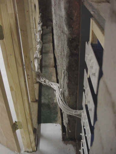

Feel the Power!
(4) 20 amp lines wired into junction boxes where each of the lines is then split making (8) lines.  The lines pass through holes in the wall that line up with holes drilled into the backs of (8) junction boxes inside the control room.
Each circuit, now in two separate junction boxes is then divided again.  The first box has two outputs, the second has three for a total of five. Four circuits with five power lines each now makes 20 individually powered lines.  Each of the lines is then routed to a dedicated switch in the panel.  A separate line then carries the power through the harness to it's own socket.
