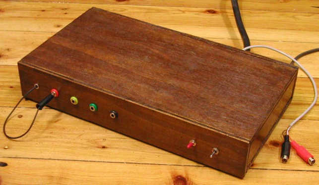

This is a manual, 4 input SCART switch box. The banana plug on the front selects the input - telephone exchange style. There's a high brightness LED mounted behind each banana socket that lights up if there's a signal at it's associated input. When a selection is made all the LEDs go out.
The phono outputs are for connection to an amplifier. Audio out can be from the TV or the external input, selected by the red switch. The silver switch can force the TV into RGB or CVBS mode if necessary (for game consoles that don't manipulate the SCART control lines correctly).

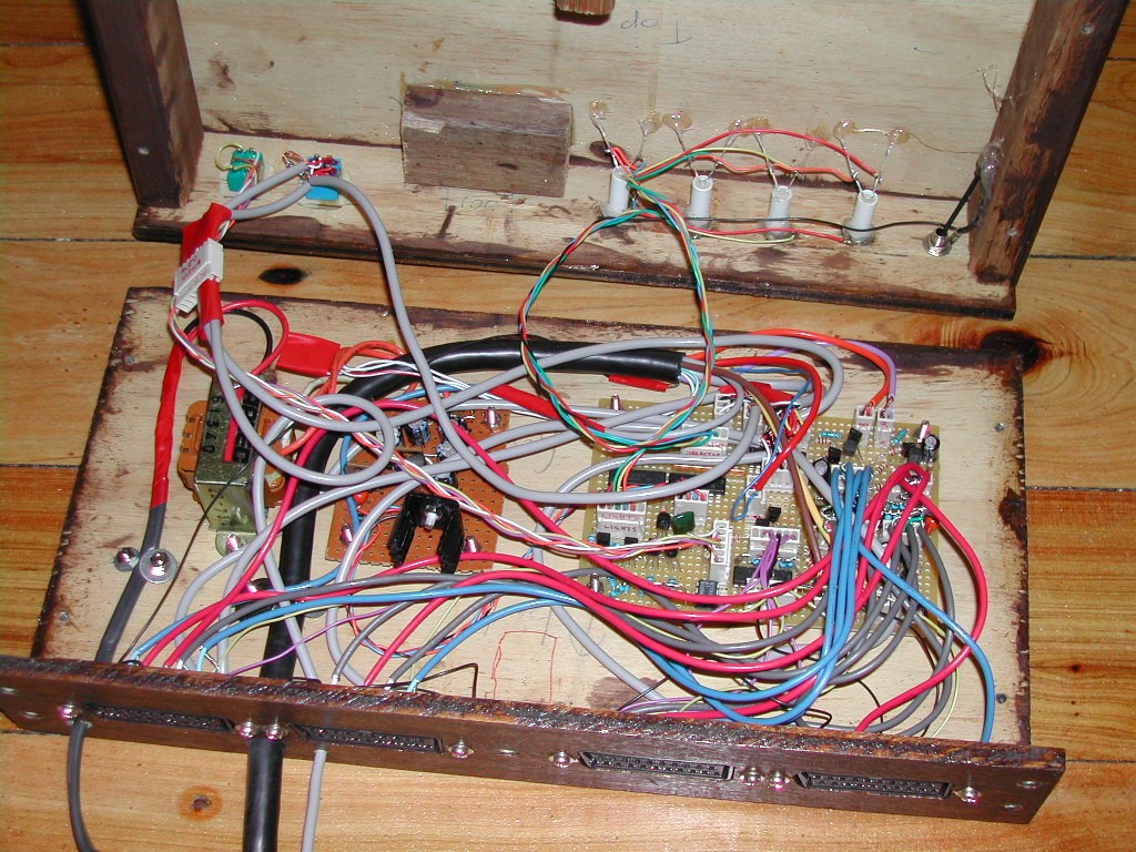

Picture of the guts 279KB
