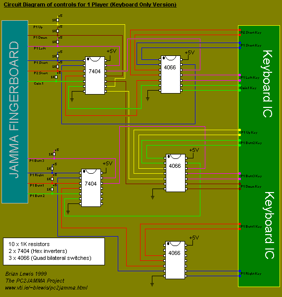

The complete circuit diagram looks like this (Click for a more legible version) 1 Player, 3 Button Version Using just the Keyboard Components 10 x 1K Resistors 2 x 7404 (Hex Inverters) 3 x 4066 (Quad Bilateral Switches) 5 x 14pin DIL Sockets The complete circuit diagram looks like this (Click for a more legible version) |
