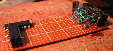

It's much easier to stack and solder the chips before they're on the board. Cut off unrequired outputs, join required inputs and bend out the pins on the 74HC374 first and second stories for the resistors. It's clear in this picture that I've forgotten to bend out the pin 11 clock input. On the left is the double stack of HC74s. Notice that I've connected the inputs of the unused half of the top chip to the inputs of the bottom chip, not +5v as shown on the circuit. I find it's easier this way, it doesn't really matter where they are connected as long as they are not left floating.

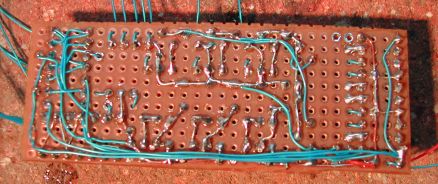

Chop up the proto-board into a piece 11 holes high and 30 holes wide. Solder the resistors onto the HC374 tower, stuff the rest of the ICs + bypass/filter capacitors on the board and we have something that looks like...

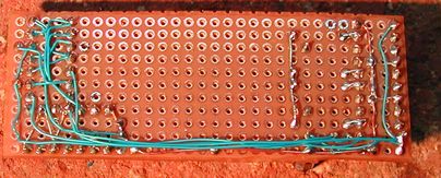

Now's the time to wire up the power supply lines to each chip. Once that's done all the logic wiring between the ICs needs to be taken care of. Keep the wires short and neat.
The final part, the video amplifier, is added in the middle. This connects to the isolated pads mid right in the picture above. Each input/output each need a wire soldered to it and poked up through an adjacent hole.

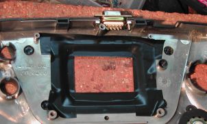

Use a file/cutters to cut a chunk out of the case above the screen for the 9 pin sub-D connector to be mounted. I recommend the female version because if you use a male connector one day some dope will plug a joystick into it and break something. When filing/drilling the case, place some tape around the edges of the screen opening to prevent plastic filings from getting trapped behind the plastic. Assign one of the pins on the sub-D as the 'ground' pin and solder a wire between it and the outer metal shell (or just wrap it around the screw).

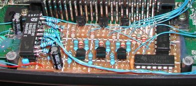

Blow out all the dust, put the guts back in and solder wires to the 9 pin D connector and to the various places on the main board. When everything is soldered in place (and all wires double checked) plug everything in, power it up, and see what happens. Hopefully the game (you put a game in, right?) is playing on the TV. The game gear has a lot of noise on its power supply rails. In my game gear this noise got into the video amplifiers and appeared as interference in the picture. To remove this I recommend putting an inductor in series with the +5v line that feeds our little board. This inductor should have 10µH or greater inductance and no more than an ohm or so of resistance. I used a 22µH RF choke.
When everything is tested and found to be working, place a strip of electrical tape
along the PC under the cartridge slot. Then place our modification board on top and hold
it in place with hot glue along the sides. If something goes wrong later the board can be
easily removed by cutting the hot glue.
