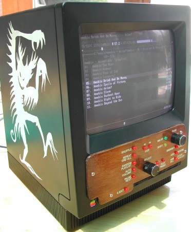

I thought that my Macintosh SE would make an ideal enclosure for something...Another MP3 player? Why not. Now there's a PC in there running Mpxplay, a DOS based audio player.
The player will play audio CDs as well as MP3/Ogg Vorbis audio files from either a CD-ROM or it's internal hard drive. Ease of use is very important here. I think it's pretty good job there, with a good set of controls and a big 80 column display. The controls are designed specially around Mpxplay, taking advantage of some of it's best features and making it easy to create playlists. And there's not a single navigation menu (well...unless you count he file browser) - each button does what it says it does.

I'd heard that Vinyl Colour/Dye paint for car interiors was good for painting PVC/ABS plastics. And it's true! The black paint looks really good and is quite tough. It's certainly not perfect, and I'm sure in a few months time there will be white bits showing through on the edges, but I'm pretty pleased with the result. The artwork on the left side (stolen from the cover of Tromatism's LP) is the original mac plastic showing through. It was done with a simple stencil method: first sand the side flat with fine sandpaper (so paint doesn't seep under the sticker), cut out the design from an A4 sticky label, stick on, paint over, peel off when dry.
The front panel was made from 3mm plywood. There labels were done with dry-transfer lettering. I had a really hard time finding a supplier of small white lettering. No one local seems to sell the stuff and most of the online suppliers of the stuff wanted huge amounts of money for either the lettering or the postage. After lots of emails I finally found an online shop that would sell me a packet of the stuff. They're called Minute Man Electronics. I thought I'd mention them because they were really helpful and didn't try to rip me off with excessive postage fees.

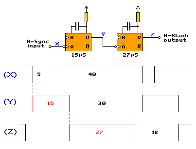

This bit was quite tricky. The Mac SE, like all the early compact macs used a 9" monochrome monitor that operated at a22kHz scan rate. I traced out the circuit of the mac's horizontal and vertical deflection circuits and discovered that the horizontal section is incomplete. What I mean is, inside a standard video monitor there is a horizontal oscillator that drives the horizontal deflection system even when there's no video input. When a video signal is connected the horizontal sync pulses, provided with the video are used to synchronise the horizontal deflection with the incoming video. In the case of the mac's monitor there was no horizontal oscillator, the so called "/HSYNC" line goes through a logic inverter then straight to the base of the horizontal drive transistor. So, in fact, this monitor requires a horizontal drive signal not a horizontal sync signal (as there is no oscillator to synchronise).
To solve this problem I simply used a couple of one shots (74LS123) to reshape the sync
pulse into a drive pulse. It seems to work ok, a more elaborate option would be to have a
local oscillator and keep it in sync with a phase locked loop circuit but I went to the
simple option. The following diagram explains it all. Times are in microseconds. And the
H-Sync frequency is what we want it to be, not what it is (yet).
