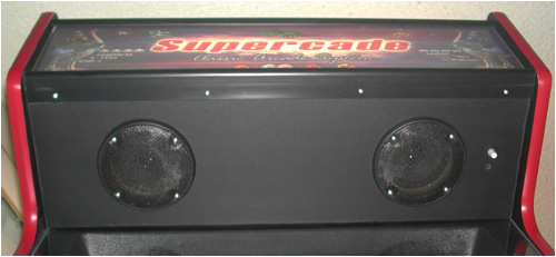

For the speakers I bought a pair of cheap PC speakers and removed the electronics. I threw the speakers out and used magnetically shielded speakers from Happ controls. I took the electronics from the PC speakers and attached it to a small board, with the volume knob sticking out the front of the panel. The whole panel was covered in formica (the same technique used on the control panel). The result is that the speaker volume can be controlled using the small knob to the right of the speakers. The headphone jack is also accessible.
