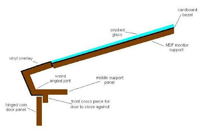

My solution for this was to cut a 3/8" rabbet on the sides on the bottom of the panel. This would allow the bezel panel to sit 3/8" lower than I had originally anticipated. However, since I didn't want the control panel to sit lower as well I created a 3/8" rabbet on the top of the bezel panel that the control panel could rest on. This would also create a lip between the control panel and the bezel panel so the black cardboard bezel and glass had a place to sit and the entire thing would be flush when finished. The picture below is a mock-up of what I am trying to accomplish.
![](http://3.bp.blogspot.com/_CXccc8RIW9I/RYsJuSgUFBI/AAAAAAAAAAM/22N8i6GnBNw/s400/CP+and+bezel+Option+%232.jpg)
As you can see, I am going to use the control panel as a lip for the glass and cardboard bezel to rest on. Once they are installed the entire surface should be uniform.

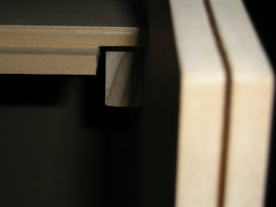

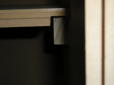

The next pictures show how I cut the bezel panel. The close-ups are of the side showing the rabbet cut which allows the panel to sit 3/8" lower than I had originally planned (creating the space for the cardboard bezel and glass).

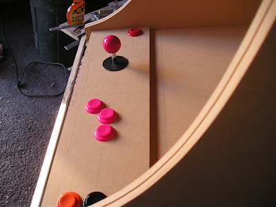

The next picture shows the front rabbet across the width of the cabinet.
