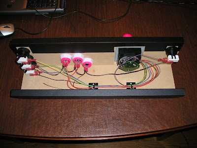

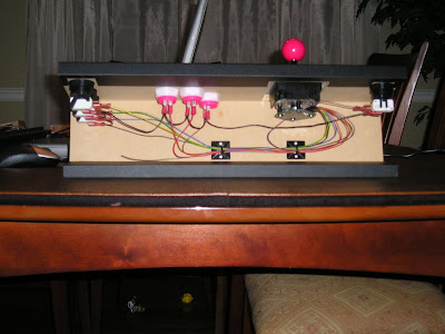

Here are some pictures of the completed wiring job:
![](http://2.bp.blogspot.com/_CXccc8RIW9I/RiY8DHmRWPI/AAAAAAAAAWg/ZOeFuAWq6RM/s400/Arcade+2+230.jpg)
![](http://4.bp.blogspot.com/_CXccc8RIW9I/RiY8GnmRWQI/AAAAAAAAAWo/iR5pZaA7_xo/s400/Arcade+2+232.jpg)
![](http://2.bp.blogspot.com/_CXccc8RIW9I/RiY8KHmRWRI/AAAAAAAAAWw/omzvuj43TF4/s400/Arcade+2+233.jpg)
![](http://1.bp.blogspot.com/_CXccc8RIW9I/RiY8M3mRWSI/AAAAAAAAAW4/230NW7bja-w/s400/Arcade+2+236.jpg)
Thanks for looking!!
