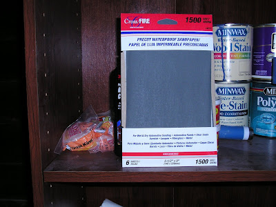

Now comes the "fun" part. Once the lacquer fully cured (over a two week period) I sanded it down to a super smooth surface. I spent 5(!) hours sanding one side of the cabinet. Five hours. One side. I used 1500 grit sandpaper, a palm sander, and a sponge. This is the sandpaper I used:
I divided the panel into thirds and spent about an hour and a half wetsanding each third. I'm still not finished with it entirely. I can still see a bunch of reflective sparkles all over the place when the light hits it just right - these are small divots that are still present even though I've sanded like crazy. I don't know what to do next - I'm debating whether or not to continue sanding this week trying to remove the tiny divots or if I should move on to the rubbing compound and polish. I'm not so sure the rubbing compound does anything to be honest - I applied a bit to a lint-free rag and started rubbing it in and I didn't notice a difference at all with the finish. The divots were still there.
