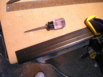

I toyed with the idea of using velcro to hold the retainer in place but the thickness of the velcro made the retainer sit about 1/16" off of the surface of the cabinet which wasn't going to work. The retainer also needs to be removable so I couldn't just glue it down. I decided to use 4 evenly spaced screws to secure it to the cabinet so the next thing I did was mark off where I wanted the screws to go. I decided on placing the two end screws 1" in from the end of the retainer and then I measured for the other 2 central screws so they would be spaced evenly. To place the holes, I measured up 1/4" from the plastic line that is part of the retainer (you can see it in the pictures).

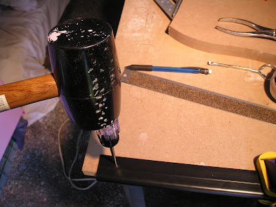

Using an awl and my trusty rubber mallet, I marked off the holes where I would eventually drill. The reason to mark the holes with an awl is so the drill bit does not slip out of place.

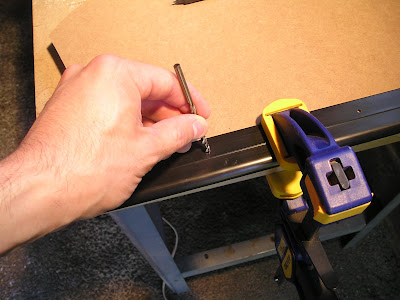

After the holes were marked, I drilled them out using a 1/8" drill bit as shown below. Make sure the retainer is clamped in place as you drill so it doesn't slip.
You should get a nice clean hole for the screw as shown:

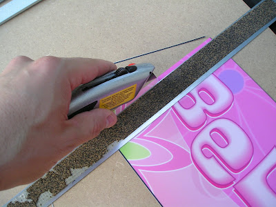

The next step was to cut the marquee and the plexiglass to the proper size. This was pretty easy to do and just required a lot of trial and error. Mamemarquees printed the marquee a little oversized but all it took was a razor and straightedge to cut it to size.

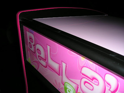

Now that the retainer, plexiglass and marquee were all cut to size, I clamped everything in place, drilled out the pilot holes and secured everything to the cabinet using 1/2" screws. Once that was finished I capped each screw head with a screp cap to give it a clean, finished look.
Here are the results:
