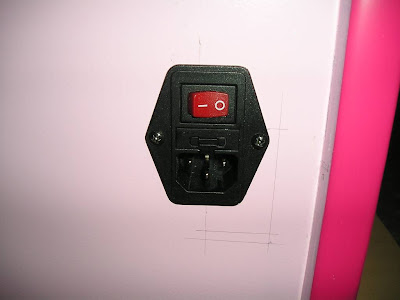

It's installed - and more importantly, it works! Or at least it seems to work - no sparks, no smoke and the SmartStrip has power so I'm reasonably sure the installation was done properly. After much discussion about the right and wrong way to wire this thing over at BYOAC we collectively figured out which wires from the SmartStrip should be connected to which wires on the plug recepticle (I hope). The last step to installing the plug recepticle was to cut a rectangular hole 1-1/16" x 1-13/16" out of the back panel.
Easy, right? Wrong. It took over 2 hours to cut out the hole accurately. After laying out the hole I started by drilling out as much material as possible using a large drill bit in each corner. Then using a very small keyhole saw I connected the holes to remove most of the material. That wasn't so bad - what was excruciating was trying to square everything up to the lines. I ended up using a metal file because I couldn't get one of my chisels in there to really do anything due to the small size of the hole. I thought this would take 5 minutes!

And here's the hole post-installation - I secured the plug recepticle to the cabinet using two screws and then added some screw caps for a "finished" look:
Here's a close-up without the screws holding it in place:
And here's a super close-up of the finished installation. I still have to erase the layout lines that I made since I couldn't decide where to put the thing and still leave room on the inside to mess around:
It looks pretty nice.... or at least nicer than a round hole with a plug hanging out.
The only thing left to do was crawl inside and connect the wires. I reversed the black and white wires from my previous post - this is what all the discussion over at BYOAC was about. We were having a hard time figuring out which wire was "hot" and which was the negative one. Turns out U.S. Electrical Code mandates that "hot" wires are black, white wires are neutral and green wires are ground.
