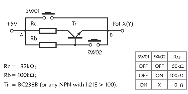

Here are some tips if you want to try to implement your own gamepad like Gravis Gamepad for PC or similar.
The gamepad works so that the movement plate has four switches (up,down,left,right) below it. When you pus it to some direction, one or two of those switches are pressed down. The keypresses are converter to resistance values usign the follwing table:
   ¦ x = 0 kohm   ¦  x = 50 kohm  ¦  x = 100 kohm ¦
   ¦ y = 0 kohm   ¦  y = 0 kohm   ¦  y = 0 kohm   ¦
   ¦ x = 0 kohm   ¦  x = 50 kohm  ¦  x = 100 ohm  ¦
   ¦ y = 50 kohm  ¦  y = 50 kohm  ¦  y = 50 ohm   ¦
   ¦ y = 100 kohm ¦  y = 100 kohm ¦  y = 100 kohm ¦
You can generate the necessary resistance values for example with the following circuit:
              +------100kohm--------+
   +5v >------+-----SW1----100kohm--+----> joystick  potentiometer out pin
              +-------SW2-----------+
Where:
SW1 = NC, normally closed switch (opens when this direction is pressed)
SW2 = NO, normally open switch (closes contacts when pressed)
Here is another circuit which works in exactly in the same way:
                     +---SW1----+
+5V >----+--50kohm---+--50kohm--+-----> joy pot out
         +--------SW2-----------+
Where:
NOTE: Those circuits can't be built with two normally open switches. If your joystick has or gamepad you want to modify has such switches then check my Convert Atari-style joystick to PC joystick ports circuit instead.

Building gamepad with just normally open switches
When you are building gamepads youself, in many cases you are often stuck with switches witch are normally open. Elvir Mulahmetovic has sedigned the following circuit to allows you to use just switches witch are normally open. The circuit is very simple.
The circuit has been included to this document with the permission from Elvir Mulahmetovic.

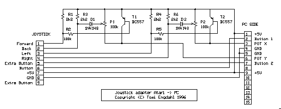

Some games are easier to play with digital joystick instead of analogue type. Unfortunately PC has only analogue joystick connector, which makes it impossible to connect normal digital joystick to it. But with a little adapter circuit, it is possible to use Atari style digital joystick with IBM PC joystick interface. The circuit adapts the joystick connectors and converts digital joystick movement signals to analogue signals. The circuit can be used with any PC game to replace the original analogue joystick. The circuit also simulates also Gravis Gamepad operations except the extra buttons.
Joystick adapter circuit diagram
The joystick adapter can be quite easily built to a small plastic box which can be easily fitted between the PC joystick adapter and the joystick you wish to use. On the picture below you can see my protoype.

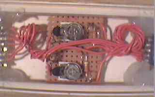

I built my prototype to a small piece of veroboard. I have not designed any real PCB for this project, so you have to design your own PC or build your own circuit to some protyping board. Take a look at the inside of my prototype to get ideas how to lay out the components in your circuit. On the left side you see the 15 pin male connector and on the right there is 9 pin male connector. Both connectors are glued to the case using hot glue.
Inside circuit picture

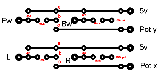

Placing the components on the circuit board
I have not designed a circuit board for my circuit, because I only needed to build one such circuit and it was easy to build to veroboard. The circuit is not very sensitive to any noise or interference, so you can quite freely place the components on the veroboard as you like. The following circuit board layout (designed by Peter Larsen from Denmark) which you can use as an example for your own circuit board or for designing the way to put components to veroboard. If you want to have a larger view of the circuit board, click the picture to get it enlarged.
Circuit board layout for joystick adapter
The circuit operation
The interface circuit directly connects the joystick buttons to the corresponding PC joystick connector pins because they operate similarly in both joystick types. Because PC need different resistances to X and Y inputs to know the joystick position, the circuit converter the four switch inputs form the Atari stick connector to the different X and Y resistance values which are the outputted to PC joystick port. The circuit gives the following resistance values from the 9 different positions an Atari-style joystick stick can have:
                            UP
 LEFT  ¦ x = 0 kohm   ¦  x = 50 kohm  ¦  x = 100 ohm  ¦  RIGHT
                           DOWN
The resistance values are exactly the same as what is given by PC gamepad controllers (like Gravis Gamepad for PC) or what normal PC analogue joystick give out when it is in center position or in any extreme position (fully moved to one of the eight main directions).
The different resistance values are generating using following method (this example is for forward/back direction movevement):
Left/Right movement conversion works in exactly the same way. Normal digital joystick button is wired to Button 1 input in PC joystick interface and one extra button in digital joystick connector is wired to the Button 2 in PC joystick interface.
NOTE: The transistors and and diodes are absolutely necessary for this circuit to work. You can't avoid using active circuit elements if you want to to convert and unmodified Atari joystick to PC josytick port. I know that there are some simple circuits which use only few resistor to adapt joystick to PC, but those can't be used with unmodified Atari joysticks. They require you to completely rewire internals of the joystick (which is not always possible as shown in their circuit diagrams). The intention of my circuit was to make the circuit general and avoid any changes needed inside the joystick.

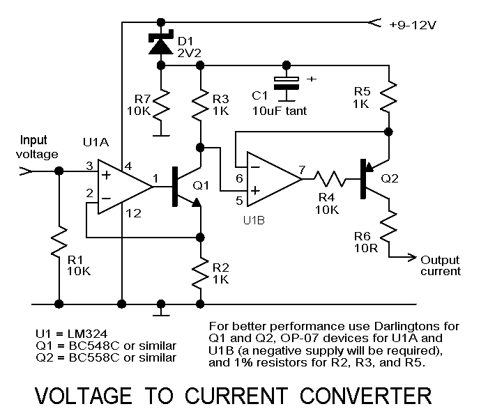

A voltage signal can be converted into a variable current signal, and a circuit to do this is given in Figure 5 in the FIGURES archive. This circuit converts a positive, ground-referenced voltage into a positive current source that can be fed into one joystick position input. The relationship between input voltage and output current is linear. 1V on the input produces an output current of 1mA. The circuit requires a 9-12V supply, which is unfortunately not available on the joystick port, though you could use a switched capacitor voltage booster (e.g. the Linear Technology LT1054) or a switching supply (e.g. the Motorola MC34063 or the National Semiconductor LM2574 series) to produce a higher voltage rail from the 5V output on the joystick port, but be aware that switching power supplies can create a lot of electrical noise.
The picture below is the circuit diagram of the voltage to joystick input converter. If you want a larger view on the circuit diagram, then click the picture to enlarge it.
circuit diagram
Because the relationship between input voltage and time measured is reciprocal, a zero input voltage will give an infinite timeout. Obviously this should be avoided, as it will prevent software from reading the inputs within a reasonable period of time. This can be prevented by ensuring that the input voltage never falls below a certain threshold, or it could be prevented by incorporating an offset in the voltage to current converter. In the very unlikely event that you are interested in pursuing this, I may be able to help so please drop email message to Kris Heidenstrom.
