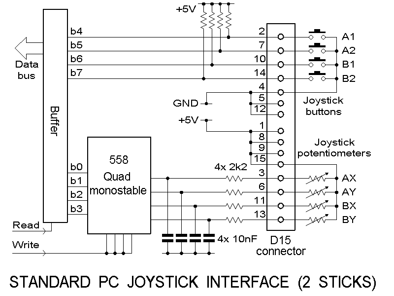

Circuit diagram of PC joystick interface
The following circuit diagram is from PCTIM003 document and is Copyright by K. Heidenstrom. This picture is included in this document with permission from K. Heidenstrom.
This circuit block diagram applies to all PC joystick interfaces from multi-IO cards to PC soundcards. In PC soundcards the pins 12 and 15 are used by MIDI interface which has it's own electronics separate from the joystick interface.
The 558 chip used in PC joystick adapter is a quad version of a popular
555 universal timer chip. If you are not already familar how 555 universal
timer operates then it is worth to check
555 timer chip datasheet. The 555 timer is used as
one-shot in the joystick adapter circuit.
Because the pinout of 558 is a little bit hard to find on databooks
here is 558 pinout for those whi want to hack their joystick adapter
electronics:
1Q |1 +--+ 16| 4Q
1RCext |2 15| 4RCext
1TR |3 14| 4TR
CV |4 13| /RST
VCC |5 558 12| GND
2TR |6 11| 3TR
2RCext |7 10| 3RCext
2Q |8 9| 3Q
