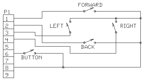

Atari 2600 video game was one of the first TV games which became widely succesful. Atari 2600 video game used 9 pin digital joystick interface which later became a de-facto standard in home computer industry. I could not find original Atari 2600 spacs, but here is the specs from Commodore 64 interface which uses the same pinout.
Pin Color Function 1 White Up 2 Blue Down 3 Green Left 4 Brown Right 5 no contact 6 Orange Fire button 7 Red +5V, max. 50 mA 8 Black Ground 9 no contactHere is a typical circuit diagram sor Atari 2600 stick:
