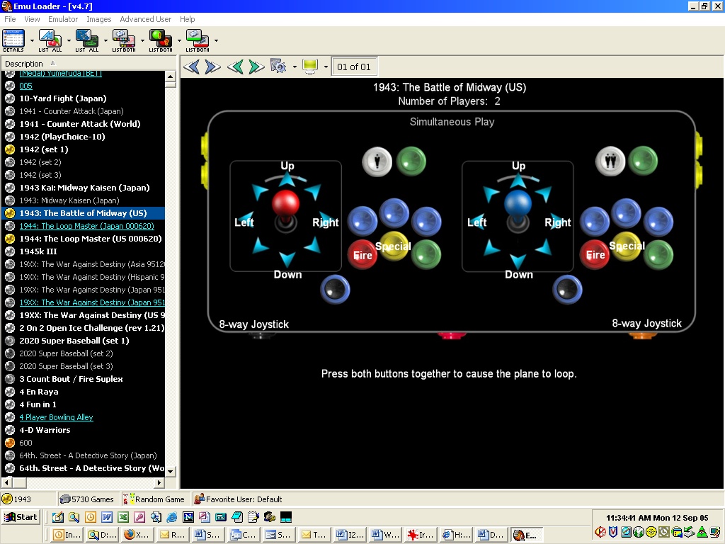

Basically, this is done by creating a "fake" controls.ini
file and letting Johnny read this. MAME must be installed for
Johnny5 to work properly, but all the data will be gathered from the
Johnny5 layout file and the "fake" controls.ini file.

- Unless passed as a command-line flag, Johnny5 searches MAME
for the parent and driver of the romname. It uses this to
detemine controller file key assignments. Fortunately, if the
romname is not found, it assumes the default key assignments.
(This is the first thing we will exploit.)
- Next Johnny5 searches controls.ini for gamename, or
parentname or drivername. It uses this and the previous MAME
controller inputs to determine key mapping. In other words -
From MAME, P1 Button 1 is L Ctrl. From controls.ini, P1
Button1 is FIRE. Therefore, L Ctrl = FIRE.
Fortunately, it makes no check for whether the controls.ini
entries are valid MAME entries - (MAME does not actually support 14
game buttons for Player 1, but Johnny5 does!) (This is the
other exploit.)
- Finally, Johnny5 uses these key mappings and information
from the .lof file to place the label in the appropriate position.
I.e. L Ctrl = FIRE and the .lof has a label for L Ctrl right
over the red button so the FIRE text should go over the red button.

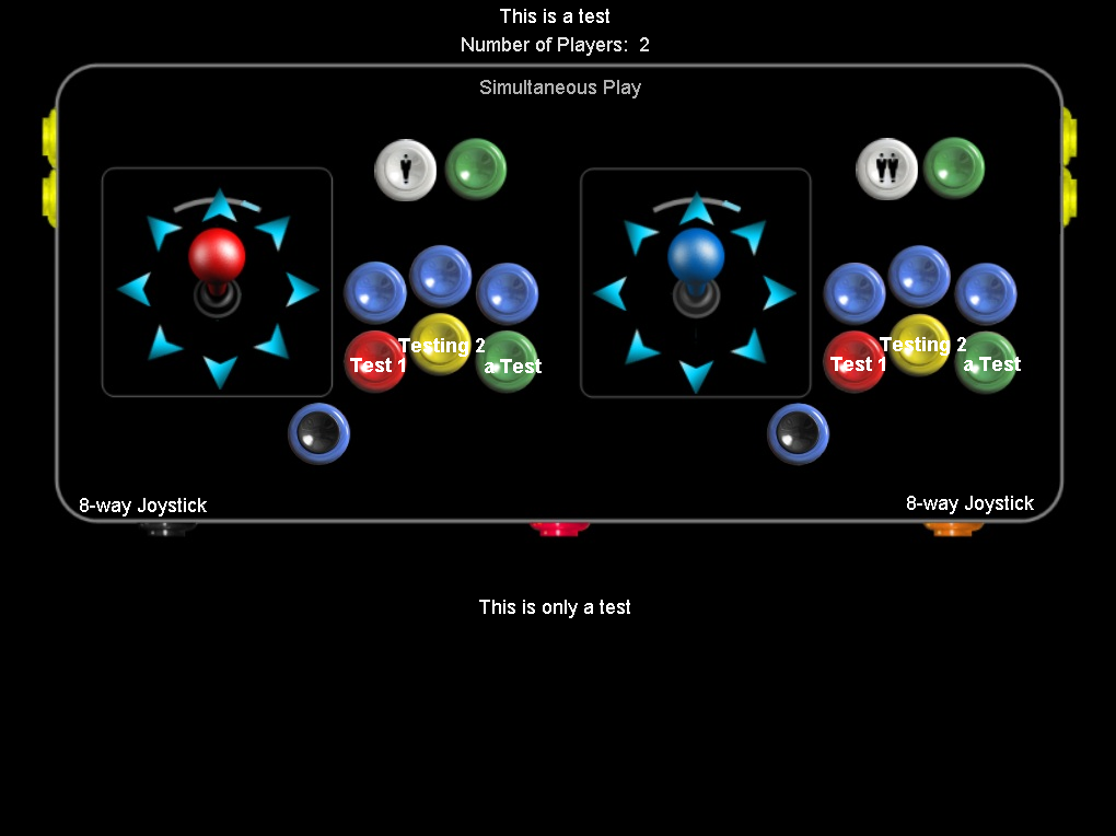

For example, let's say my buttons are labelled like this:
- and I use the default MAME
assignments in my
MAME ctrlr.cfg file and my Johnny5 .lof file. I want to set
up
Johnny5 to work with a PC game that has two buttons FIRE and BOMB.
The game uses "F" for FIRE and "B'" for BOMB and cannot be
remapped, but I want Button 7 (the blue/black button) to be FIRE and
Button 1 (the red button) to be BOMB, and plan to remap my encoder so I
can play this way. For the custom controls.ini entry, I
simply
show the game as using 7 buttons with Button 1 as BOMB and Button7 as
FIRE. This will work perfectly. The method does not
care that the game actually uses 2 buttons, not 7, nor that
the keypresses sent are "F" and "B", not "C" and "L Ctrl"!

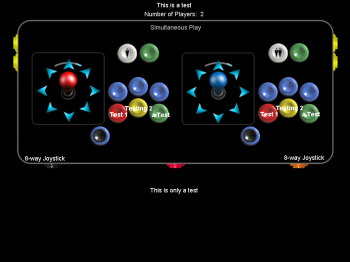

The first
thing I did was test Popcorrin's
idea of creating a dummy entry in the controls.ini file. I
modified c:\johnnypc\data files\controls.ini and added the following
between two of the existing games:
- [testgame]
gamename=This
is a test
numPlayers=2
alternating=0
mirrored=1
tilt=0
cocktail=1
usesService=0
miscDetails=This
is only a test
P1NumButtons=3
P1Controls=8-way
Joystick+joy8way
P1_BUTTON1=Test
1
P1_BUTTON2=Testing
2
P1_BUTTON3=a
Test
Then
I ran "Johnny5 testgame"
and it displayed fine, as below (click twice to enlarge):

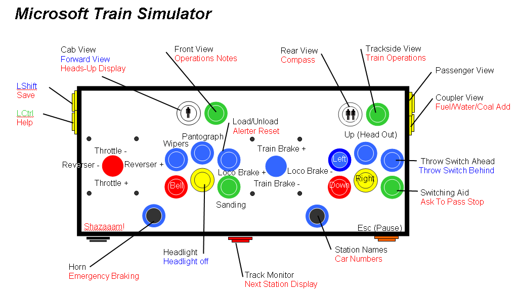

You might end up
with a lot of
defined fake Player 1 buttons, up to the limit of your encoder.
You might even include shifted inputs, which I think you
could
display in a different color than primary ones by customizing your
Johnny5 layout (.lof) file. One thing to consider is screen
real
estate for the PC games. The image below (click to enlarge)
was
something I worked up in Microsoft Word for Microsoft Train Simulator.
Red entries are shifted
entries. This
would be difficult to fit on a Johnny5 layout and impossible to view on
an arcade monitor. (And I left out some less often used
controls):

- First, here is a
screenshot of EmuLoader displaying a static image from Johnny5:
- The biggest complaint most
BYOAC'ers have
with EmuLoader is that as you can see, it is a very "Windowsy"
frontend. This doesn't bother me as I have a desktop
controller
attached to a PC that is only about 95% used for gaming (when I'm not
developing web pages on it). You can run EmuLoader in
full-screen
mode and hide the task bar and image bar, and I think you can use a
background image for the gameslist, and it will lose some of the
Windows look, but it still might not be what you want for a dedicated
arcade panel.

It is a good idea to figure out how you want EmuLoader to
launch
the games before adding them to the list. If you are using
similar emulators (RAINE instead of MAME for instance), you can copy
and
rename mame.el to cGames.el and delete entries rather than adding them
all in. I think EmuLoder needs all of the files, but they can
be
empty (open, select all, delete, save).

- Consider how you would like to handle support files
(cabinet artwork, screenshots, etc) for the non-supported games.
- Add the games to EmuLoader, preferably by creating a
cGames.el file. When doing this, you will want to keep in
mind what you enter as Name, Clone, and Driver, depending on what the
commandline for the program requires and how you decided to launch the
game and handle support files.
