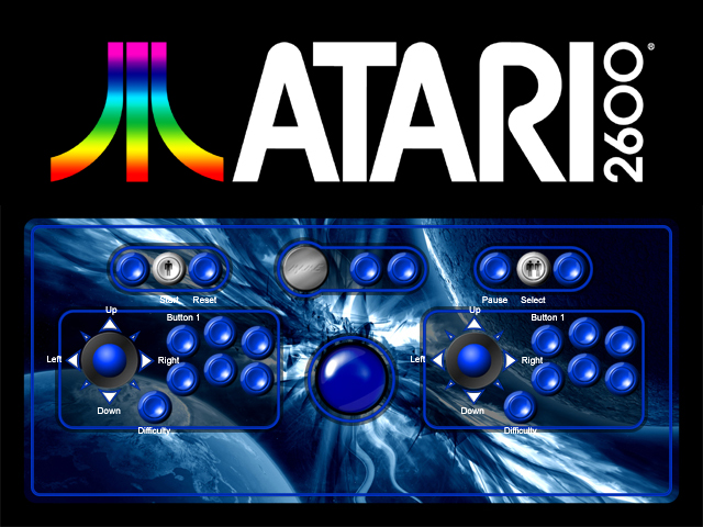

I use CPVW for about 80 patforms (console and computer). It is very simple. If you read the CPVW docs you'll see you can specify a background image to use. I have created a static BG image for each system with the logo across the top and the button hard-labeled, using Photoshop. The buttons don't really change much for consoles. I'll attach an example.
John

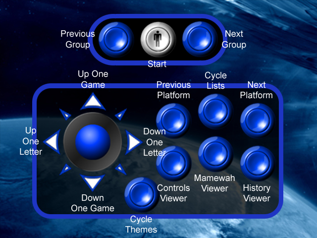

Oh, it also works great for a MameWAH controls viewer. This way your user only needs to remember one key. If they press it they get the following image and should tem know what all the controls do while in the FE.
John
