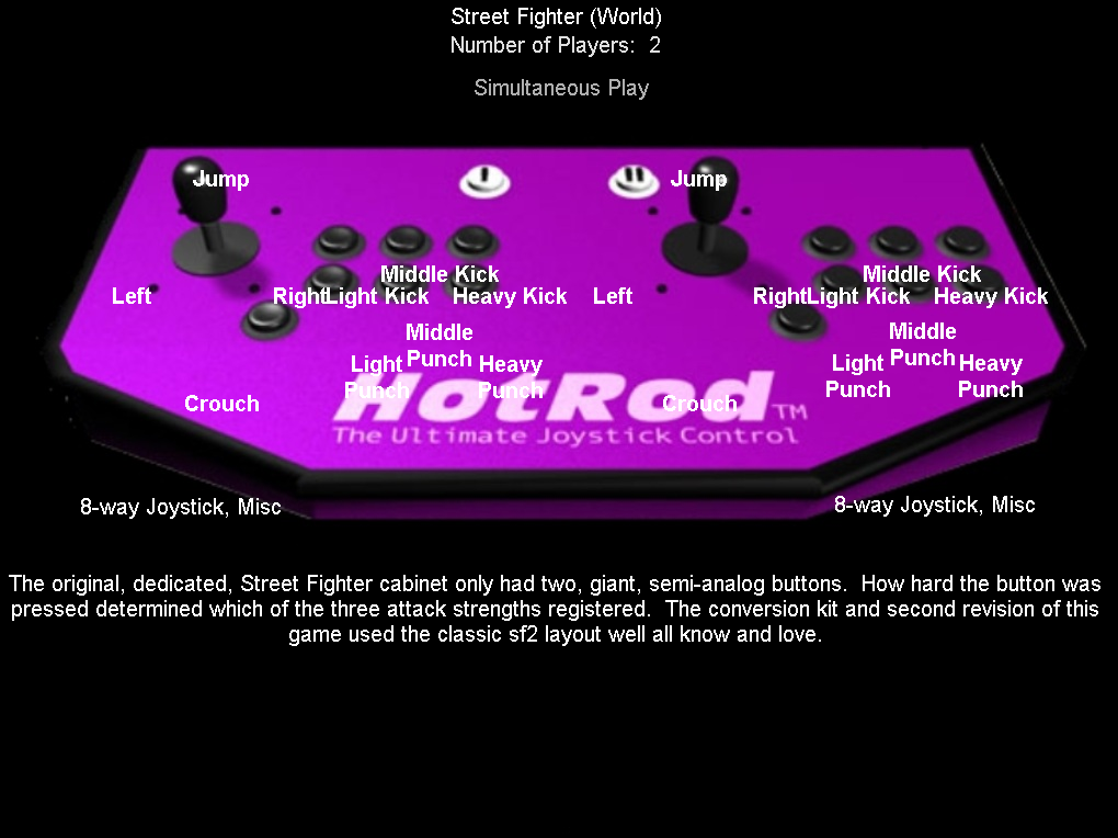

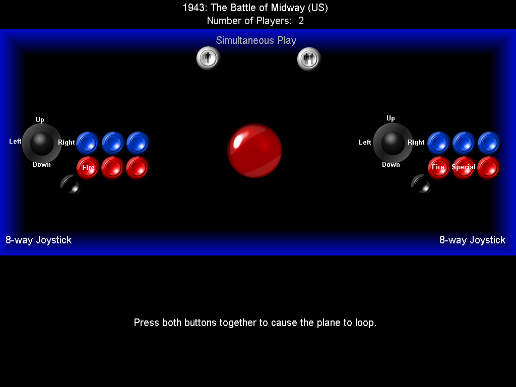

Again, here are screenshots Howard Casto's Johnny5 program with my background images showing 1943 and Joust (click to enlarge and click again to expand, they will look MUCH better):
1943-JohnnyJoust-Johnny5 Image
For my requirements, one of the main things I was looking for was the ability to display whether the Prodigy™ joysticks should be in 4-way or 8-way mode, and Johnny5 accomplishes that (see blue tick marks on images above)

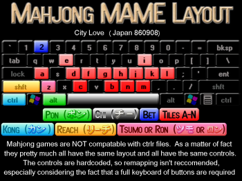

And here are the default images you will see when you first run Johnny5, this time showing 1942, Area 51, and City Love (again, click twice for full glory):
Johnny5 1942Johnny - Area 51Johnny 5 City Love
NOTE:  The missing P1B2 in 1942 is not an error.  Howard C does not use the Alt key for P1B2 to avoid Windows conflicts, so if you use a default MAME codeset, that button will not be shown.

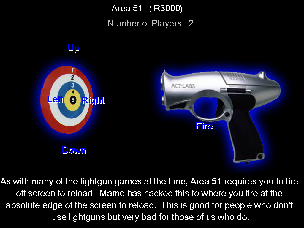

Now, for all operating systems, right-click on C:\johnny, select "Command Prompt Here", run "Johnny5 area51" and verify you see the lightgun screen above, and run "Johnny citylove" and verify you see the Mahjong screen above.

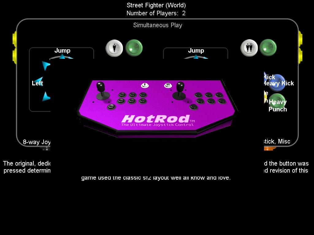

Let's say you have a HotRod SE as your controller (Howard be quiet . . .).  I will start with Ciro's Emuloader image of the HotRod SE.  (I'm sure there are more suitable images on the net, but I want to give you an example.  We will modify the base image to "black out the background" as explained in the GIMP Hints under Graphic Editing above.  Here are the original and modified images:
originalmodified
After saving the image on the right above, open Gimp, select Black for the background (click the double-arrows on the lower right) and select file new and set the image dimensions to our frontend resolution dimensions.  Now right-click and select File and Open and select your panel image.  Click in the new window, Select Copy.  Click in the original window, select paste.  Right Click and select Layers>Layers, Channels, and Paths.  Select the floating selection and Right-Click and select Create New Layer.  Now click on background.  Click in the original window and select File and Open and open the controls.png (Street Fighter image).  Click in the Street Fighter window, right-click and select copy.  Click in the original window and select paste.  Go to layers channels and paths, and save the floated layer as a new layer and move it down below the HotRod image.  You should now have the file on the left below:  The next step gets a little tricky.  The idea is we want to select the HotRod layer, turn down the opacity so we can see it and the image below it, and the scale and move the layer so it is approximately positioned over the existing control panel.  (In this case, we had to scale the image upward.  A better base image or better planning would have allowed us to scale it down, which is always preferable)  We now have the image on the right below:

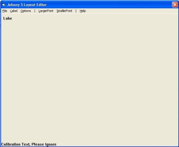

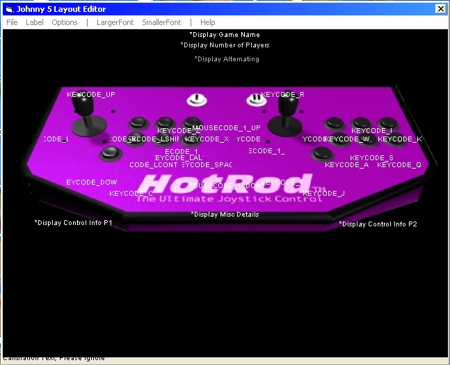

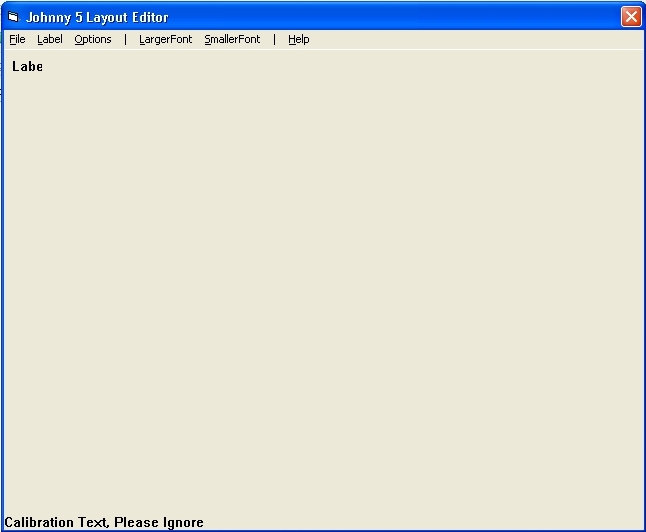

NOTE:  The next step involves opening an existing layout in Johnny5's layout editor.  Normally this works fine, but occasionally, you will get an image like the one below.  This is most likely to happen with .lof files that were saved in Windows 98, and transferred to Windows XP, etc.  Often the filename will be all uppercase even though it was not saved in uppercase originally.  If this happens, the first thing to do is try renaming the file as lower case and then re-opening it.  If it still doesn't work, try renaming it, and then if it works, change the name back to the original name.  If that fails, open the file in Wordpad or Notepad, save it with a different name, and then change the name back to the original.
error

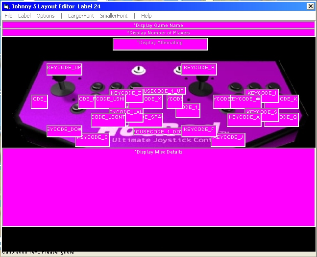

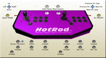

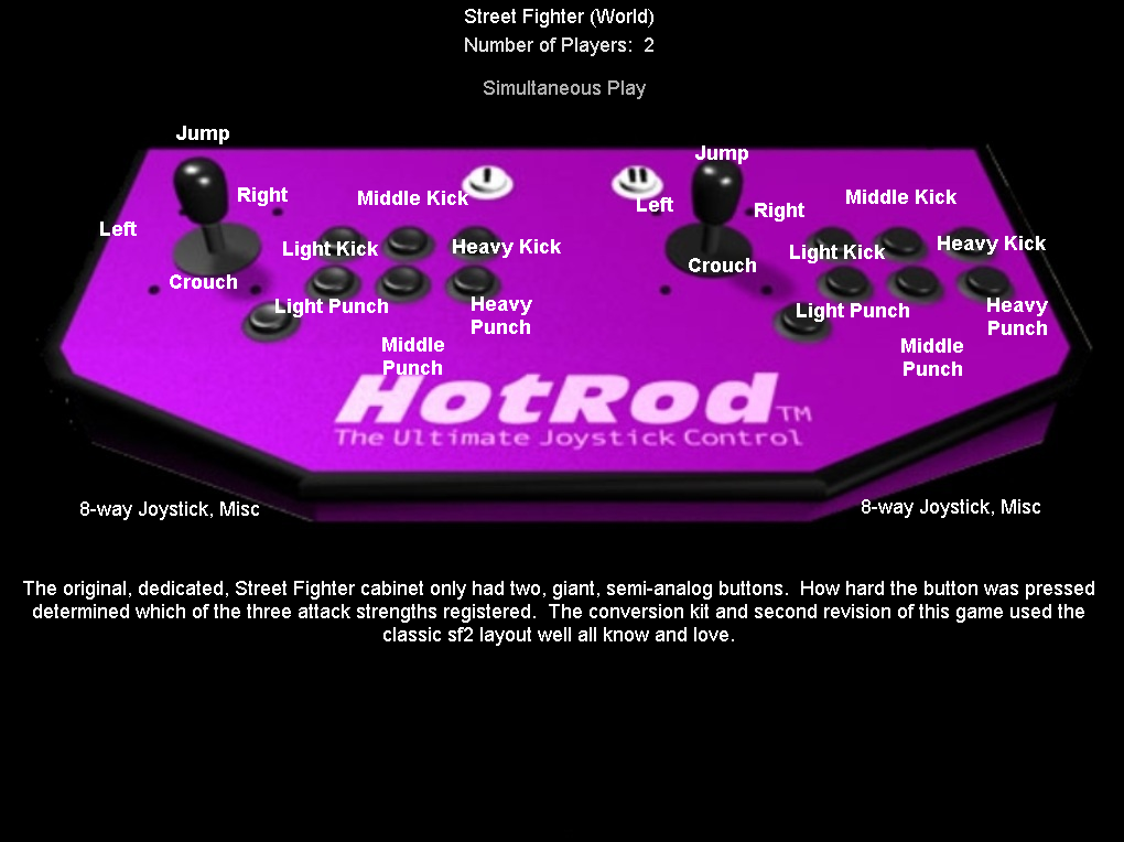

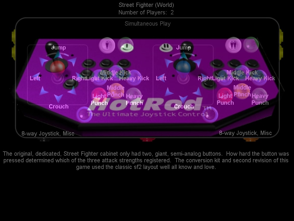

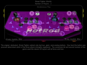

Assuming we are happy with the way the image looks, the next steps involve modifying the layout files in Johnny5.  Assuming you have backed up the default.lof file, double-click on Johnny5.exe to open the layout editor, and select File-Open-Default.lof.  You should see a screen like the one on the left below:  This is good, but you cannot see the borders of the captions with a black background file and transparent label backgrounds.  To "fix" this, press the "B" key, which gives you the image on the right (remember to set it back before you exit, or you'll have pink backgrounds on your labels):   A couple of things to note:  The layout editor does not "always" match the screen output.  As you can see, Display Misc Details is shown as overwriting Display Control Info P#, but as you can tell from the screenshots it really doesn't, so basically, you end modifying the label size and position, then testing full-screen with a few games, then re-shuffling the labels, then retesting, etc.  (Also, I don't recommend this, but it is possible to manually edit the .lof files entries.  I had to do this when the layout editor wasn't working at all for me - (in between walking back and forth to work, in the snow, year-round, uphill both ways . . .)  Information I found while doing this is posted in this thread from June 2004).  Actually, I had to modify all my .lof files tonight (the uploaded ones are revised) and I found manual editing better if you want to make sure every label is exactly lined up and exactly the same size, etc.
image5image6
So we shift the labels around, save the .lof file, run Johnny5 -sf and we get:
Not too shabby.  The "Middle" upper and lower labels are too far away from the main buttons, but I don't feel like changing them for a tutorial.  I think I finished the proof-of-concept.  The modified .lof file that generated the above image is available here.
