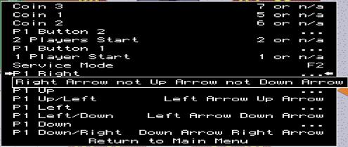

To make it play correctly, you have to go into the control settings and set it up in the following manner:
(*A)Right: J1 Right and not J1 Down and not J1 Up
(*A)Right/Up: J1 Right J1 Up
Up: J1 Up and not J1 Right and not J1 Left
Up/Left: J1 Up J1 Left
Left: J1 Left and not J1 Up and not J1 Down
Left/Down: J1 Left J1 Down
Down: J1 Down and not J1 Left and not J1 Right
Down/Right: J1 Down J1 Right
To set Right, Up, Left, or Down (in the standard build of Mame for Windows)
1) Press tab to bring up the settings menu
2) Select 'Input (this game)'
3) Select 'Right' (or 'Up', 'Left', or 'Down')
4) When entering the controls, push your joystick in the following series of directions:
     a) J1 Right ' Set the control to 'Right'
     b) J1 Down
     c) J1 Down ' Double clicking the direction makes for 'not J1 Down'
     d) J1 Up
     e) J1 Up
To set up the diagonals, simply choose the control (Right/Up) and move the joystick into the diagonal.
Here is how the settings should end up looking:
