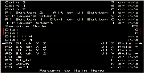

How to play using an analog joystick:
1) Download MAME: Analog+
2) Connect an analog joystick & Start 720º with joystick support enabled and mouse support disabled
3) Press 'p' to pause the game as soon as it starts
4) Press the tab key to get into the configuration menu
5) Select Input (this game)
6) Since you will not be using the Dial control, set the two dial values to 'q' or some other key that you will not use
7) Map the AD Stick X/X2/Y/Y2 to the joystick directions
8) Hit the escape key twice to return to MAME
9) Press 'p' to unpause the game
10) Start playing!
The settings to change are marked in red:

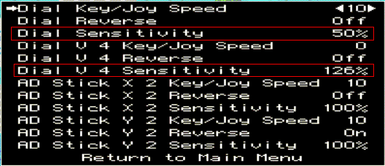

How to play using an actual arcade joystick:
2) Connect a 720º arcade joystick according to the instructions on this page
3) Start 720º with mouse support enabled and joystick support disabled
4) Press 'p' to pause the game as soon as it starts
5) Press the tab key to get into the configuration menu
6) Select Analog Controls
7) Set the Dial sensitivity to 50%
8) Set the Dial V 4 sensitivity to 255%
9) Hit the escape key twice to return to MAME
10) Press 'p' to unpause the game
11) Start playing!

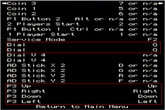

How to play using an 8-way joystick:
2) Connect an 8-way joystick or use the keyboard
3) Start 720º with mouse and joystick support disabled
6) Select Input (this game)
7) Since you will not be using the Dial control, set the two dial values to 'q' or some other key that you will not use
8) Map up/down/left/right to the joystick directions
11) Start playing!
12) If it doesn't work, try quitting the game and restarting it.
