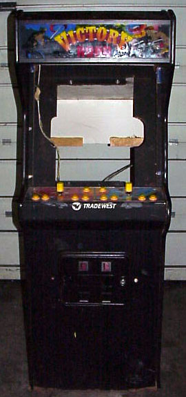

This Centipede was converted to an SNK Victory Road and the conversion added a lot holes to the control panel.  This page shows how I restored it back to a Centipede cp.

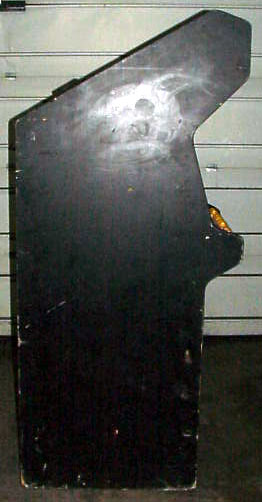

Full cabinet with monitor removed.
The camera flash makes the Centipede sideart visible under the black paint.

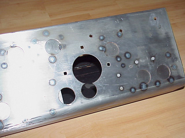

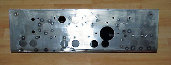

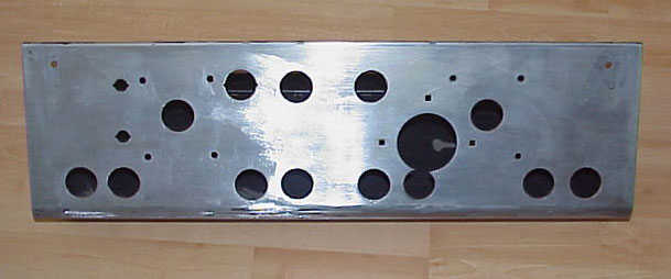

After I removed the overlay, I stripped the cp down to bare metal using Citristrip paint remover. This remover literally melts the adhesive and paint right off and you just wipe it off with a rag.

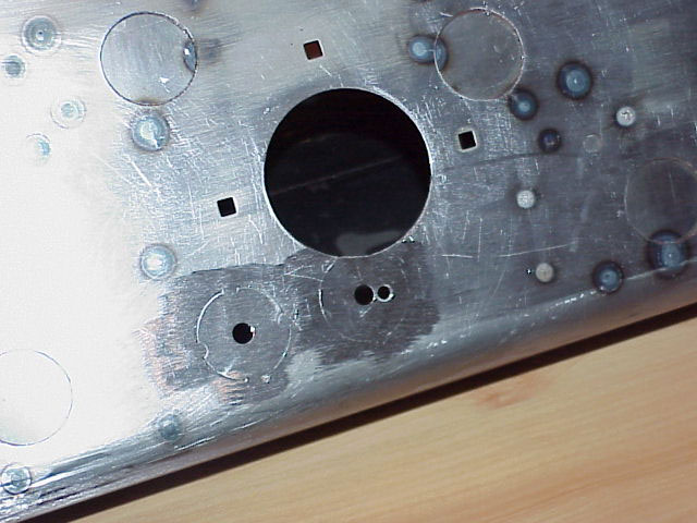

Lots of holes! The extra button hole overlapping the trackball hole will be a little tricky to fix, but it’s doable.
The hole edges had a lot of tear-out, most likely caused by a hole saw used in the conversion. After the control panel was stripped, I cleaned up the hole edges with an angle grinder.

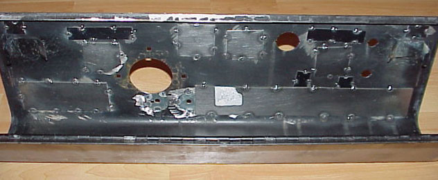

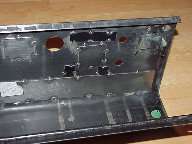

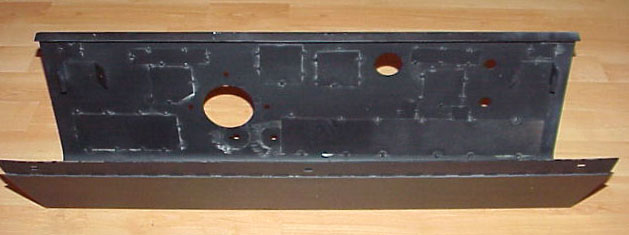

Once that was done, I cut some pieces of 16ga sheet metal to cover the unwanted holes. The metal strips were welded in place behind the holes.
There were two holes very close to where the trackball will be installed, and putting a piece of metal behind them would interfere with the trackball housing.
For these two holes, I found some fender washers in my hardware chest that fit perfectly. I welded them in and ground the welds flush. Then I used a Dremel tool to grind away the washer where it overlapped the trackball hole.
A close-up of the metal strips welded to the backside of the cp.

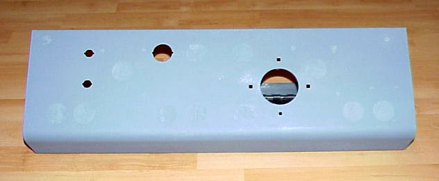

With the sheet metal plugging the holes, now they can be filled in. I used fiberglass-reinforced Bondo (#272) to fill in all the holes. The #272 hardens in about 10 minutes, and about 15 minutes after it is applied it is safe to sand down. Then I went back with some Bondo spot putty (#907) to fill any small voids. The spot putty takes longer to harden and will shrink as it dries, so it shouldn't be used on large holes unless you are ready for multiple applications.
Holes filled with Bondo and sanded.
Shown in gray primer.

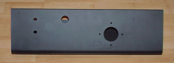

Painted black prior to overlay installation.

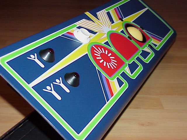

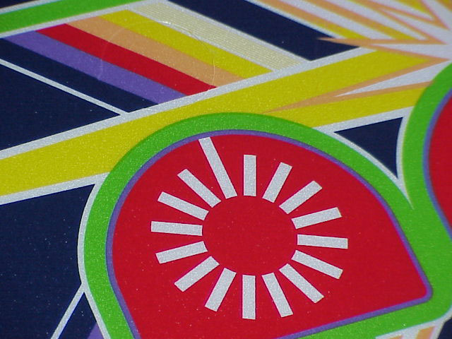

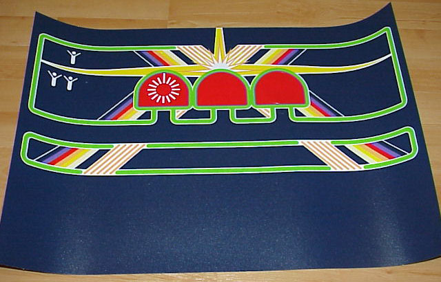

New Centipede overlay from Arcadeshop.
Close-up of overlay. Fantastic detail!

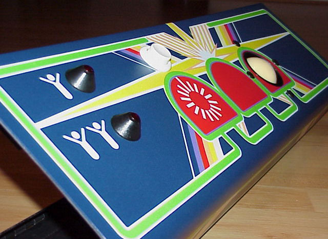

The control panel was sprayed with window cleaner (Windex) before the overlay was applied. This allows the overlay to be shifted around so the button holes line up before it is permanently stuck down. A squeegee is then used to remove any air bubbles.

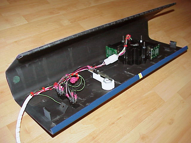

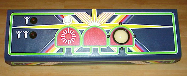

Parts & controls installed. An original Centipede off-white ball was used.
I made a wire harness and connected up the controls.
