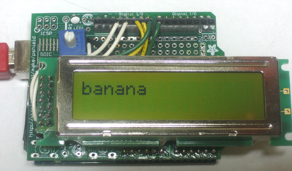

Shave & a haircut, 4 bits!

Lets connect these to the arduino thusly: D4 -> Arduino pin #7, D5 -> Arduino pin #8, D6 -> Arduino pin #9, D4 -> Arduino pin #10
Since I wasnt sure of the wiring, I used the sockets on the protoshield. Once I test and verify they are correct, I'll solder them in!
Next are the two power wires. Parallel LCDs run off of +5V so you can just solder the Vcc wire to 5V and the ground wire to GND.
Next are the 2 control wires, ENABLE and RS which we connect to pins 12 and 11 respectively.
Theres another control line called R/W that you can use to control whether you're reading or writing to the LCD. Since we'll just be writing, that pin can be connected to ground, saving another arduino pin
The last wire is the contrast control, we need to connect a potentiometer to this to make the display visible. I dont know the specifics of the input current but I used a 10K potentiometer and it worked great.
One pin is connected to +5V, the pin on the other side is connected to ground and the middle pin is connected to the contrast line.
Now place the LCD on top. Looks good!
Make sure you finish up the rest of the shield so you can plug it into an arduino. At least solder in the male headers.

Finally, start up your Arduino software, and select from the menu:
Sketchbook->Examples->Library-LCD4Bit->LCD4BitExample
Upload the sketch to your Arduino with the LCD attached, you should see a randomized list of fruits!
Hooray! You're ready to start printing your own messages. Check out the example code to see how this is done, then just copy and paste the code into your own project.
