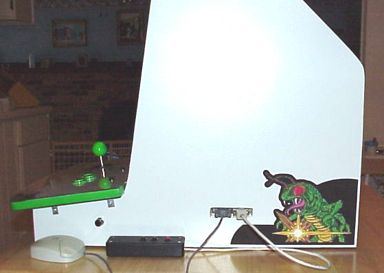

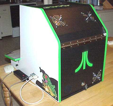

Right rear view showing admin remote and mouse connected.

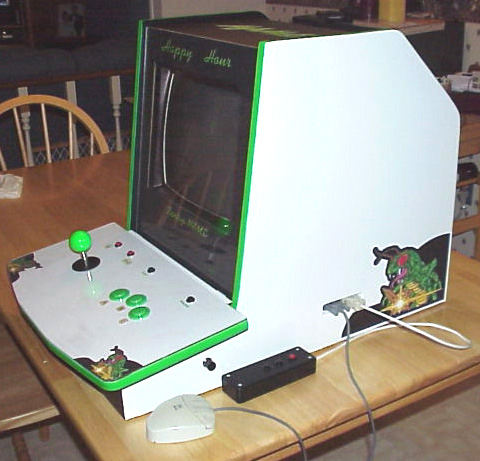

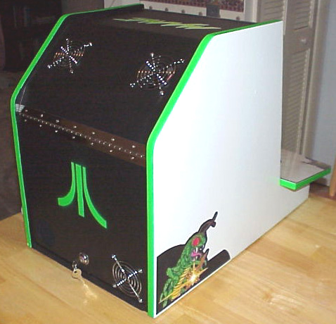

Left rear view.  The hinged back panel and cam lock is visible.
Another view of the admin remote and mouse connected to the external ports.

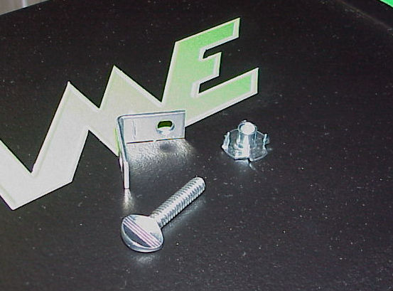

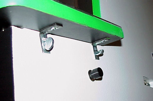

Panel clamps wouldn't fit with the small control panel, so I used a combination of "T-nuts", thumb screws, and angle brackets.
The result is a *very* solid control panel connection.  It is easy, too.  All you need to do is drill a hole for the T-nut.

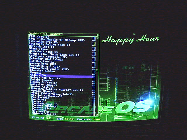

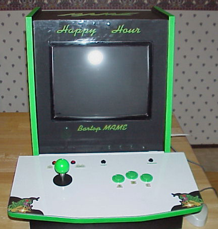

Running ArcadeOS frontend with a slightly modified backdrop.
