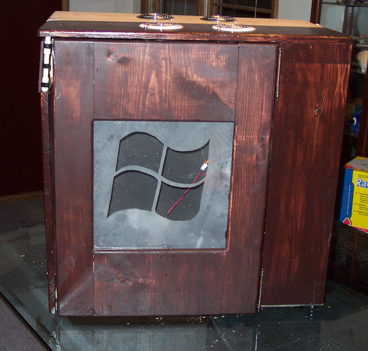

This is the Ivory Door. The main door is made from pine, stained with the same stain used in the cabinet. Not sure why the door is a shade or two lighter than the case.
The window is a sheet of plexiglass. I cut out a stencil of the Apple logo, placed it on the plexiglass, and then used Frosting Glass spraypaint. Two loads gave me a great frosted glass look, with the logo being clearly visible and the area to look into the hardware inside.
The stencil I created wasn't quite right. This window may be replaced in the future.
This is the Ebony door, created in the same way as the Ivory door. The Windows XP logo turned out great.
